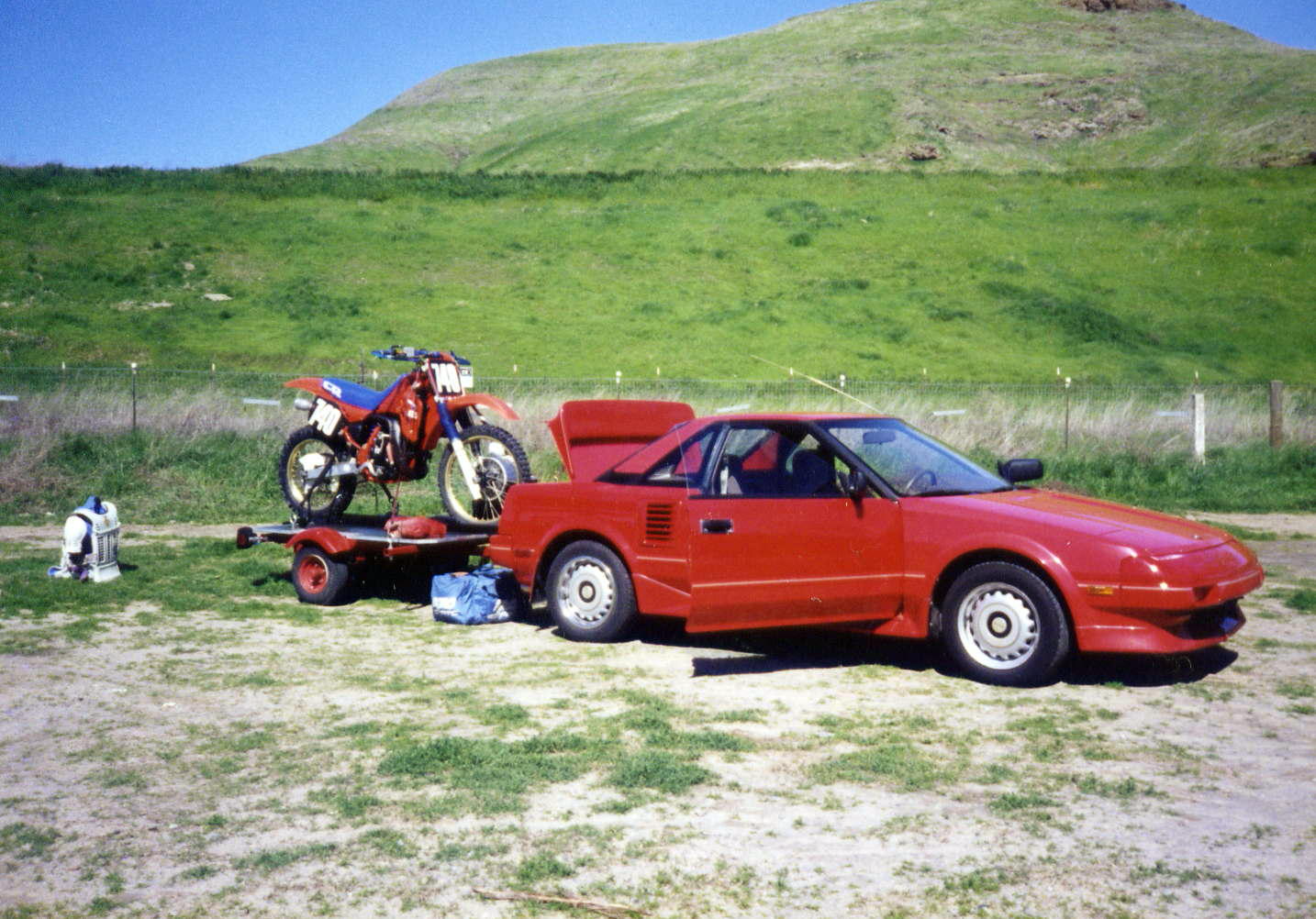

Why not just go with a trailer?
It's the most obvious and effective solution.
Trying to cantilever 350 lbs off of a small car frame is just asking for trouble, as you found out.
