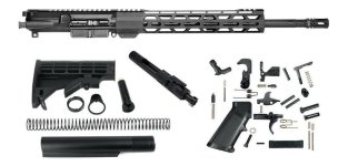

I'm starting with a $1000 budget and have NO other parts (yet). Thus, looking at the full rifle kits for starters.

I have an experienced friend who will assist if needed on the initial assembly, and I ordered something to help sort the pieces too (See below).

Some of the 'rifle kits' come with the upper already built and some rounds thru it. I didn't order mine that way.

All good tools, thanks. I only need the multi tool, and I also ordered a 36'' mat with the exploded view for ease of reassembly. The dry fire rounds are cool, so I got those too.

Full rifle kit, minus the lower.
I have the lower coming separately.

I ended up going with righttobear.com.
