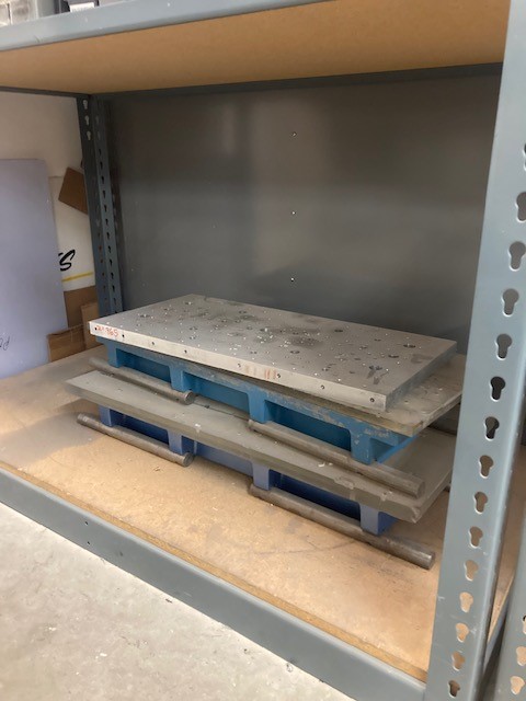

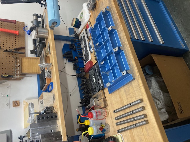

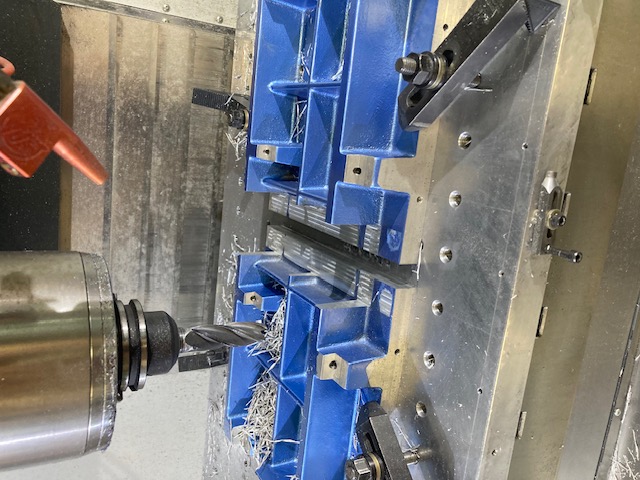

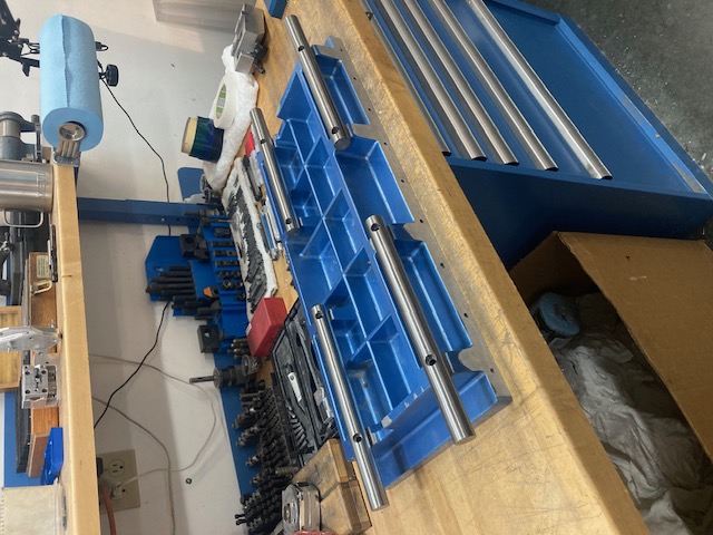

What do you do when its kinda slow at work but you have weird parts to hold? Welp, sometimes you get to make new tooling! Start with an old, too big to use easily, cast sin plate that you have a collection of gathering dust:

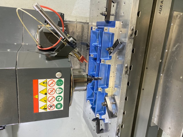

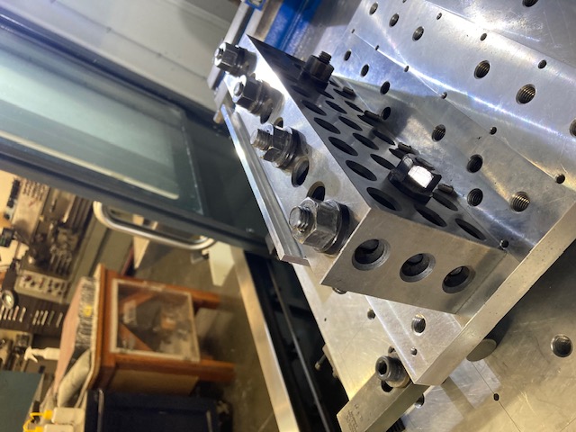

Next, clean em up, scratch your head a bit and ty to dope out how your going to make this work:

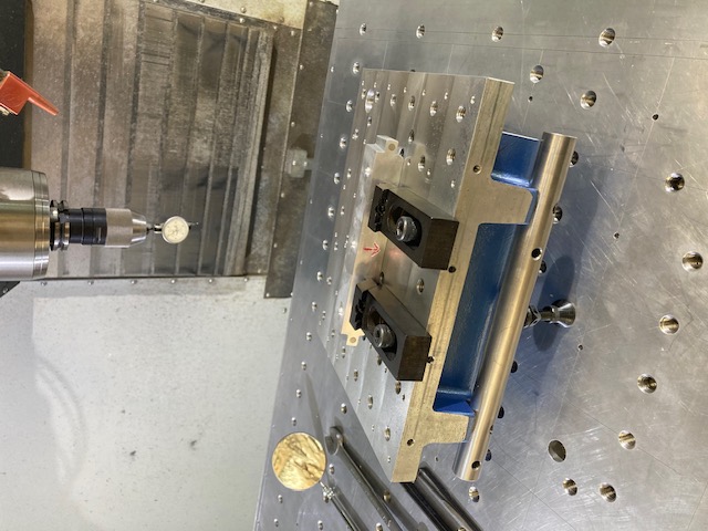

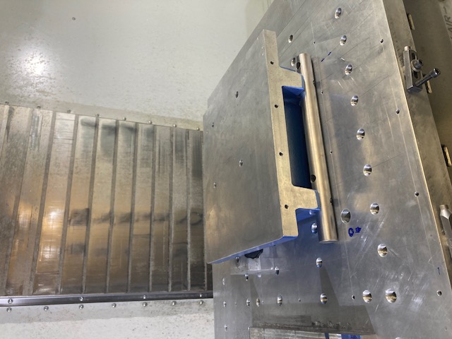

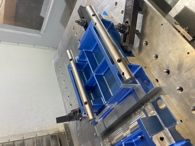

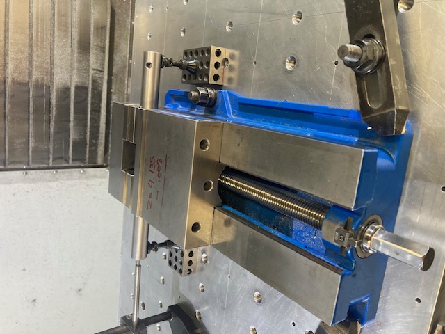

Notice how the steel rods are offset to one side? That won't work if my plan on chopping these in 1/2 to make one big thing into two small useful things is going to come to fruition. time for some figuring...

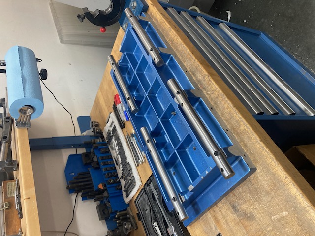

Ok, now were gonna poke some holes...

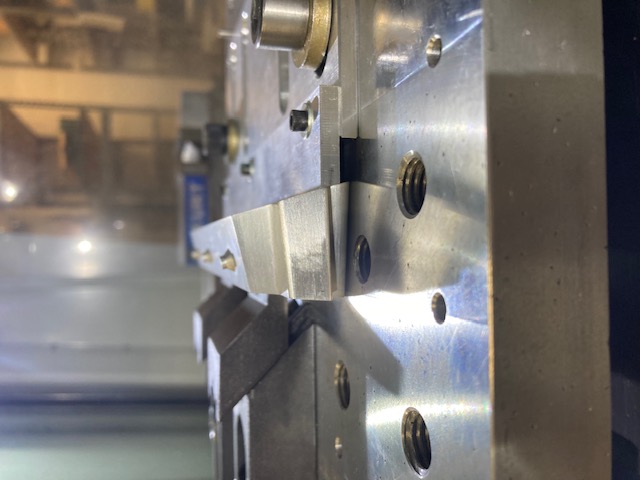

Success!

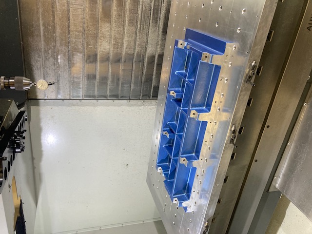

Now about that big cast plate..

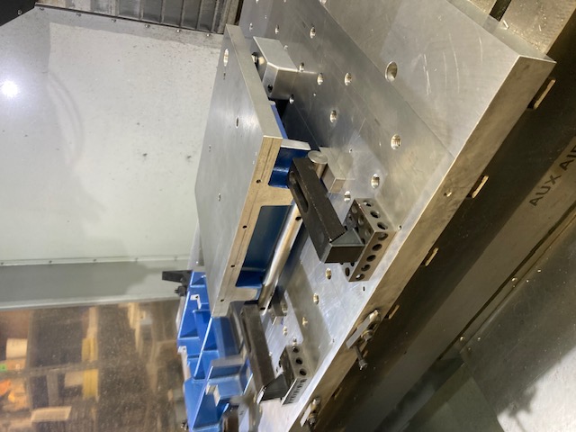

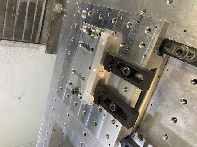

Ok we have the table spilt and the rods modified, now what?
Its hard to see them but, there are a pair of machined bosses that bolt to the sub plate and capture the round rod at the back of the plate. The plate will pivot about that point and be supported and clamped on the rod at the front of the table. like so...

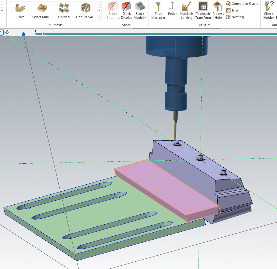

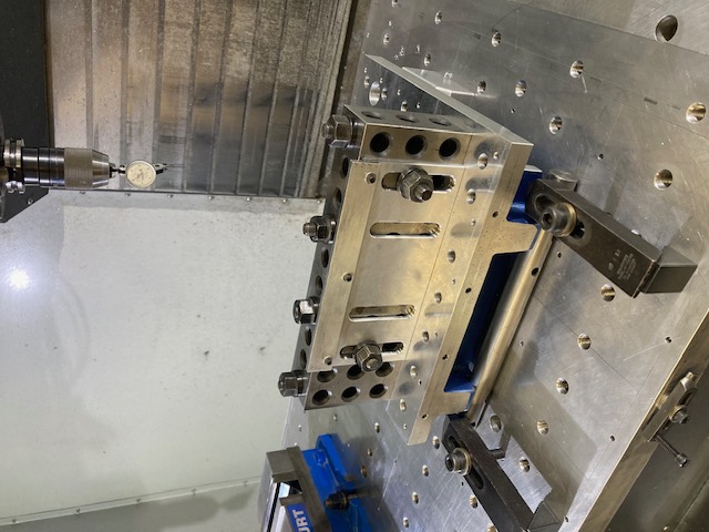

In the next pic you can see how a part will mount to the sin plate. Also note, by this time I have drilled and tapped the plate for 1/2-13 hold downs and bored .188 dowel pin holes for easy fixturing.
the two sliding toe clamps at the front of the part will be pushing against the part to lock it into place. Originally I though that simple dowl pins against the back side of the part would be sufficient to keep the part down and in place. Nope. I had to get fancy. The solution was a sliding "soft jaw" with an angle cut to match the part angle. The slotted plate is universal and can be used on any part. The bolt on "soft jaw can be easily cut to match the angle of any part. The plan...
Super happy accident on this one, I just happnes to make the 1/2-13 and .188 holes work perfectly to mount 2-4-6 blocks in the vertical position!

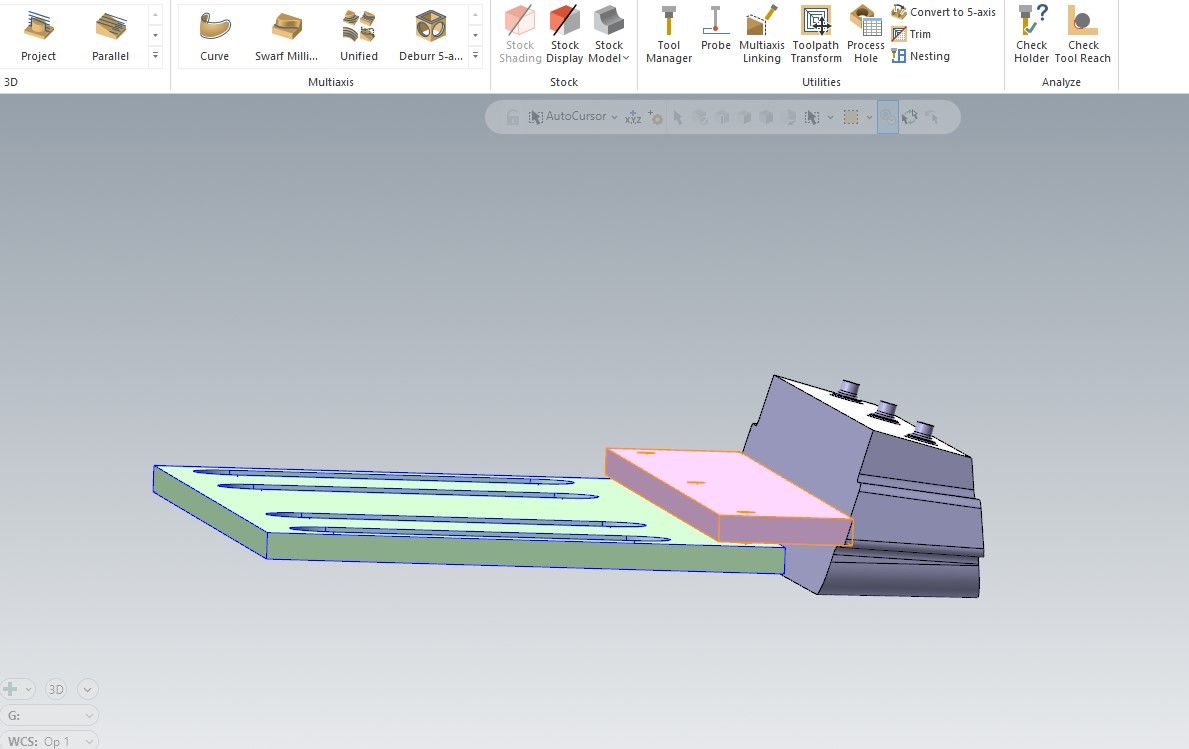

With the slotted plate mounted to the 2-4-6 blocks, I could cut the angle I need into my sliding soft jaw. Boom!
Now we are cooking!! with that set up, the part was rock solid and No gap formed underneath it. Only thing left was to tilt the table up. until that nippled surface was perpendicular to my spindle and then modify the part. We needed to reduce the size of the nipples
Worked perfectly. I have already used this contraption on two other parts. Im pretty stoked on all of it ;)
