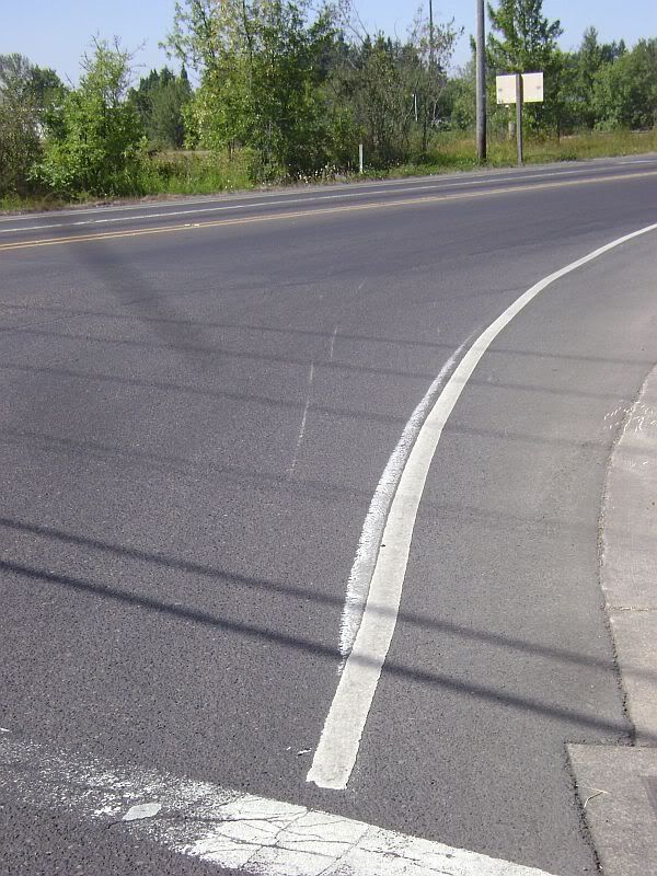

Glad you're ok, Dave. (Can I just say that, and not analyze the crash? I know this is Enchanter's domain...oh, ok, I'll play)
I'd point to the scrape marks' location relative to the crosswalk paint. The fog line looks fairly new and slick, it's possible you touched that while apexing the corner. Also Dave, debris that could cause the front to wash out may not be there afterwards, due to traffic "cleaning" it up.

I don't think I caught the fog line, but it's possible. Thought I was further left than that.
Yeah, there could have been debris, but I sure don't recall seeing any as I made the turn, and I looked back there after I got back up and didn't see anything obvious.
While the strips may not be as slippery as the newly painted ones, being on the side, they are parts of the road less traveled.
As you go from the road surface to the stripped surface, there's a brief change in traction there. If you were on a gas (coming out of a turn), this brief 'transitional space' could cause enough power slip (like a skip).
Some bikes have an abrupt on/off throttle and this can cause that 'jump/skip'. One remedy is like what TZ said, crack the throttle open early. I used to have to do this on my old K1200R. It actually helped to stabilize the bike better through the corner path.

Road:
Couldn't see anything unusual today when I took these pictures

There's a lot of info in this pic; yer trajectory 'n scrape marks show you weren't go'in too fast, and the fact that yer scrape marks are going "down the road" (As opposed to shooting out into the oncoming lane) indicates you were past the apex when you lost the front.

1.) Yer dunlops SUCK!!! 3 yr old D404s? :wtf Look at the pic, there's no sign of a skid mark or tire sliding. You know why? Cuz there wuz no grip! Bias ply tyres suck, I'd see if'n thars sum way ta get radials fer that bike. with radials there's mor grip, and when they do slide it's much mor predictable, 'n controllable. :thumbup

Yes, I was definitely at or past the apex. I was either maintaining throttle or starting to add.

Dave, the combination of you stating that you were off the throttle, that you sometimes drag a peg through this turn and what sounds like a lowside from sliding the front, I'd propose it's possible you are habitually late getting back on the gas.
In any corner, whether you have turned in gradually while on the brakes or quickly after braking is done, you want to crack the gas open as soon as you have reached max lean angle. This not only optimizes traction, but increases your cornering clearance, as both ends of the suspension are more extended while on the gas than off.
You may be right that the paint helped to initiate the slide, but the chances are you could have gotten through the corner if the gas was cracked open at that point.

I tend to agree, and it's worth pointing out that reaching maximum lean does not necessarily equal passing the apex of the turn. If a rider turns in late, maximum lean will often be achieved prior to reaching the apex, and the time between would be marked by having a high lean angle combined with a heavy load on the smaller of the two contact patches - a formula for losing the front.

After some more consideration of that corner - and a few more trips by it - I have found that at the point that I went down, I was definitely back on the gas to accelerate out of it. So I think that, combined with going over the paint which is very smooth (I've stopped and looked at it close up), is what caused the front to tuck and me to go down.
So from now on I'm going to be MUCH more wary of painted lines, especially when I'm starting to accelerate and shift some of the weight off the front. I also think in general it will help me be more aware of surface conditions and when I should back off slightly.
