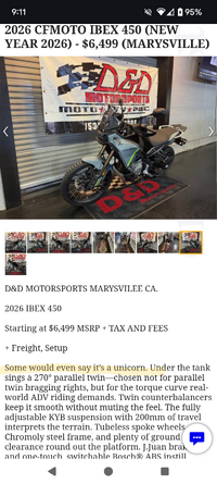

I just placed a deposit on a Chinese Unicorn!
Ms. G, how's that unicorn treating you?

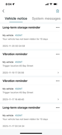

One day I’ll write up something on the giggle machine. In the meantime, the little Unicorn sends me messages.

Finally, ownership established, Comm Link hot, & Ride Requests Recorded,
This is what I wanted to know, How Needy will the bike get?
I have foreseen all this nagging, and bailed, Didn't want to get THAT involved.
But, Do Tell, , ,
